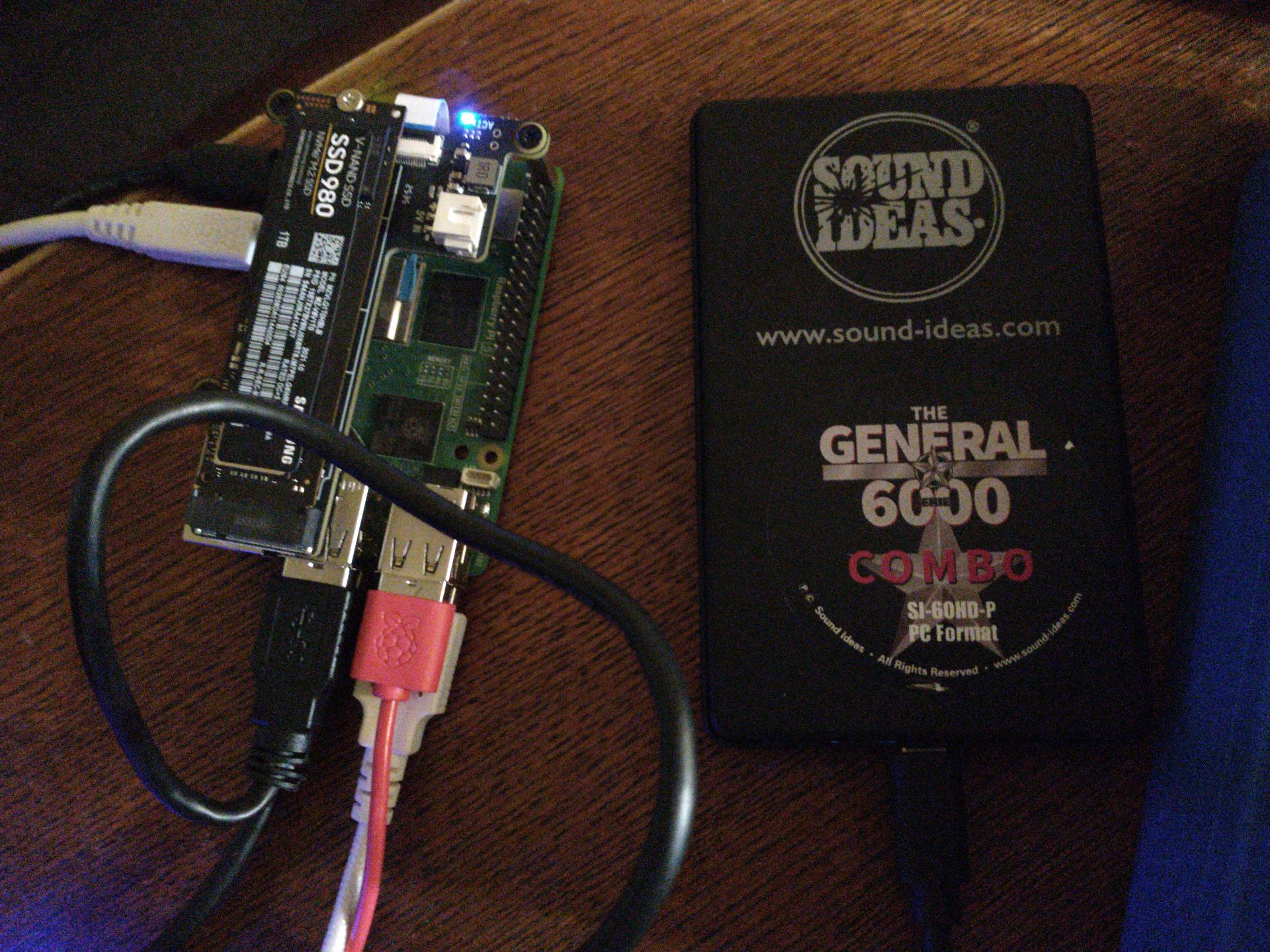

Before, I was using just the Pi5 itself with a keyboard, mouse, and one USB3 going to a HDD+NVME hub. Doesn't leave space for much else, and it was otherwise just running off a 256GB high endurance SD card, which is still relatively hoping the thing doesn't die. At worst, I had chunked 1GB of RAM in a RAMdisk to save the card some writes.

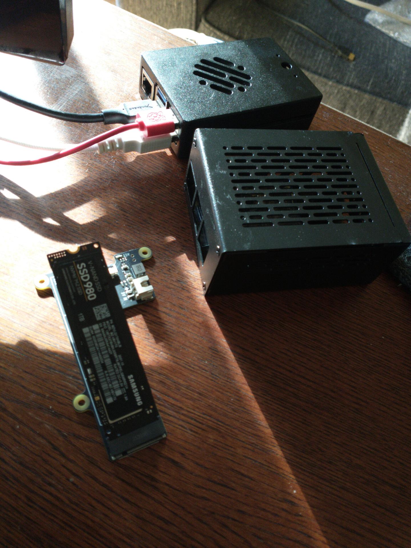

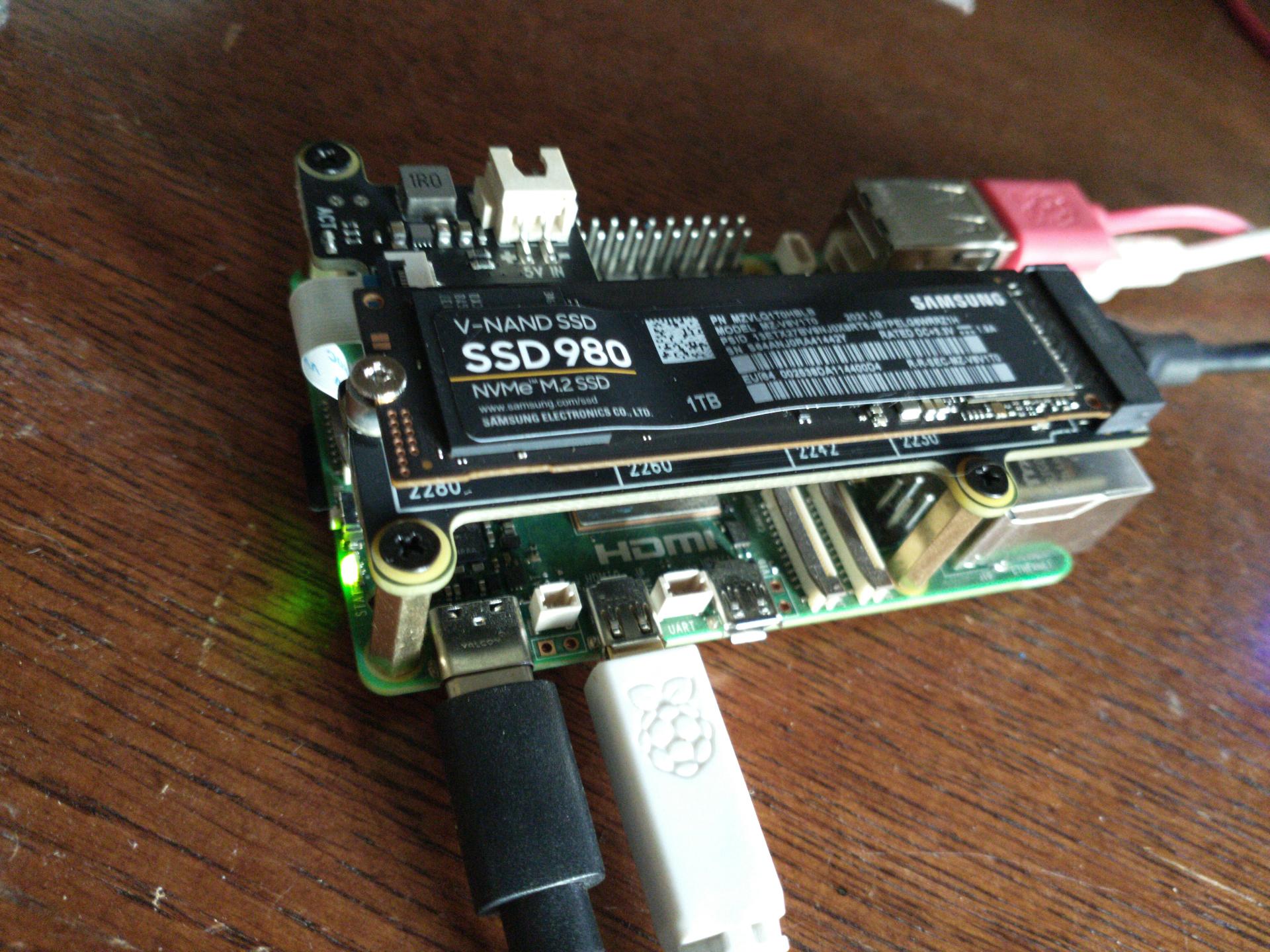

Luckily, my old System76 laptop had an old 1TB SSD and two 1TB NVMEs. Removed one and got a M.2 hat for the Pi. With SSD prices these days, I find myself inclined to pull out some of my lesser used ones to get extra use.
The hat took some figuring out, and sticking ribbons between the board and hat is bewildering how it works (once I got it in.) Plugged it in, booted from my SD card, and flashed Raspbian OS Lite with Raspbian's own flasher. For the record, Raspbian's desktop interface is just awful. I wanted to give it a chance but XFCE is so much more useful and powerful without taxing the hardware too bad.

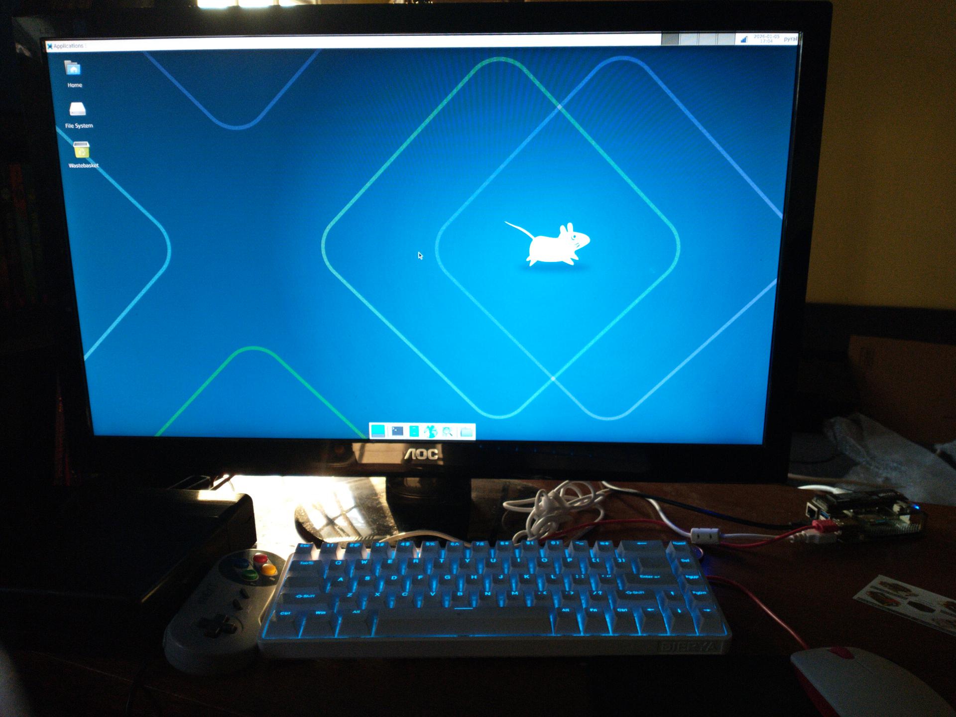

It didn't take long to go from terminal to XFCE fully booting, at least. I still find myself having to remind myself raspi-config exists as it makes stuff easier. Now this is a full and fresh Raspberry Pi running off a terabyte laptop NVME. Way more stable at least than an SD card, maybe even a tiny bit faster. No idea if the Pi's CPU is a bottleneck or if it matters at this hardware tier.
